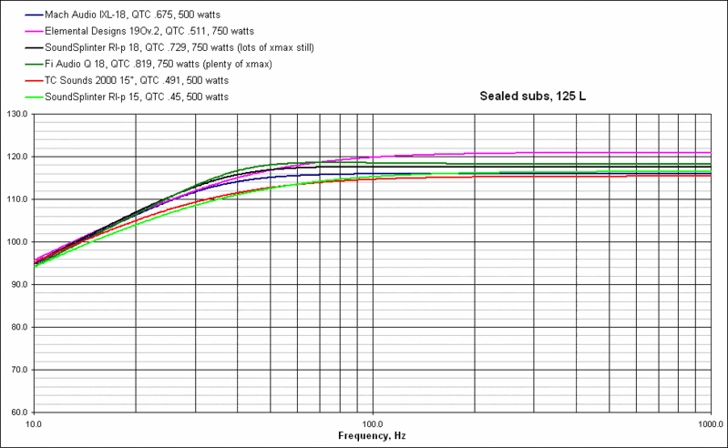

    So here's the comparison I'm looking at. I included two 15" models, but would really rather have an 18 for down the road.
    So there's that...what would be my coffee table sub. Some annoyingly high QTC numbers though, right?

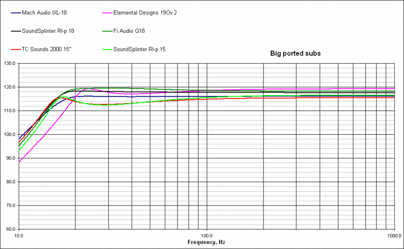

    Here they are ported..I did these enclosures pretty quckly, so don't think they're optimized at all. The boxes are 300-500 liters & tunings from 15-20ish hz.
    As far as I'm concerned, this ported graph rules out the Elemental Designs model..I was cool with the polycone, but its lack of the lowest of low end is no fun. The Mach5 is just middle of the pack (power handling) and still seems like a great value, but will I later wish that I had the extra output & excursion?
    Basically, I'm looking for someone more experienced to chime in and let me know what he would do. Would it be so bad to live with a high Q sub for a year? Well, maybe a couple years, it's hard to tell. I'll probably be pleased by anything right now and really want to be sure I'm happy with what I have when I go big--sonotube style. I want to Mach 5 to win because of its price, but the Fi & SS offerings seem to have some performance advantages. They both have aluminum cones too, don't they? Eh, discuss, liven this place up a little :W , let me know what to do.

        Tommy--thanks for the clarification on Fi's cones and encouragement toward Mach 5. I don't want to consider multiple subs..by the time I can do that I'll probably be thinking about IB and new drivers. Mainly trying to see a single sub option.
        joe--the loudness is no problem. I'm still in college and loud music is going on all the time. Having thee definitive output would make me proud . Disturbing neighbors is absolutely not an issue. Maybe after I graduate it is, but I'd rather over do it now & back off it later. Interesting thought about the bass shakers, too. Thanks
          I'm not a fan of poly cones for subs. Poly isn't very stiff that eliminates eD.
          All the other drivers are very good, it's just a matter of deciding how much you want to spend. The IXL 18.4 is the current best bang for the buck. After the sale the price goes up to $250.
          The SS Rl-p 18" would be my choice for either a sealed or ported sub with a single driver sub, were money no object.
          For a very high performance IB sub I'm partial to a 4 pack of the Fi .Q18"s, since we get those for the cost of the .Q15" when 4 drivers are purchased.
            Thomas, you think the Fi's will outperform the IXL18's for IB? It looks like they don't roll off as fast (given the Fs difference I'm not really surprised)...

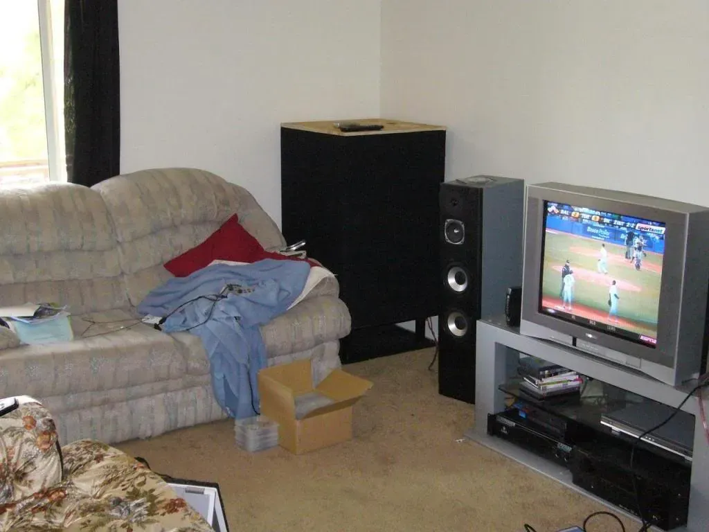

                      I've been saying that I am going to take a pic of my sub... Hopefully today I'll get a chance to upload some pics of mine. I did my sub in birch and it is really heavy, as in around 80lbs for a 5ft^3 enclosure. I did an end table design with mine but ended up using it as a normal table for my school books.
                      Hopefully later tonight I'll upload a pic; gotta finish my "design a lightpole" project first .
                      • Inu_Yasha
                        • 256

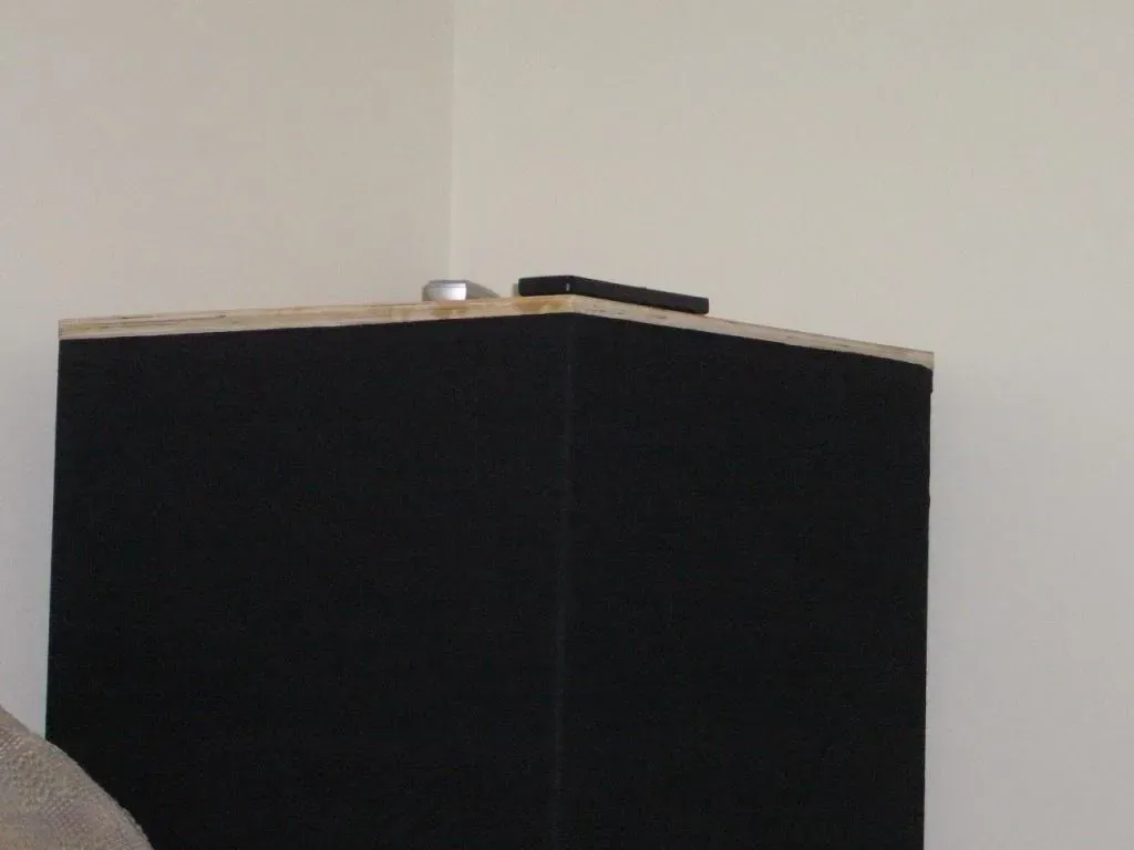

                        Ok, as promised here's some pics. Sorry it took so long to take them, but I for some strange reason decided to visit my folks down in Gulf Shores, AL. Anyways, my sub is a RL-p15 in a 5 cu*ft box vented and tuned to 16 hz (bent pipes).
                        Latest news coverage, email, free stock quotes, live scores and video are just the beginning. Discover more every day at Yahoo!
                        • cobbpa
                          • 456
                          Cool pics, nice work! Definitely doesn't look too far from what I hope to end up with. I wish I had money right now for the SS 18...eh, maybe I'll get lucky and have the cash sooner than I expect. For now it's the Mach 5. What are the downsides to having a smallish ported box? Just less port use / output? I'm thinking I'll keep mine sealed in 5ish cubes, but you've ported yours. Hmmmm

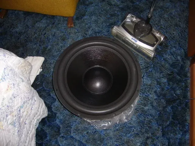

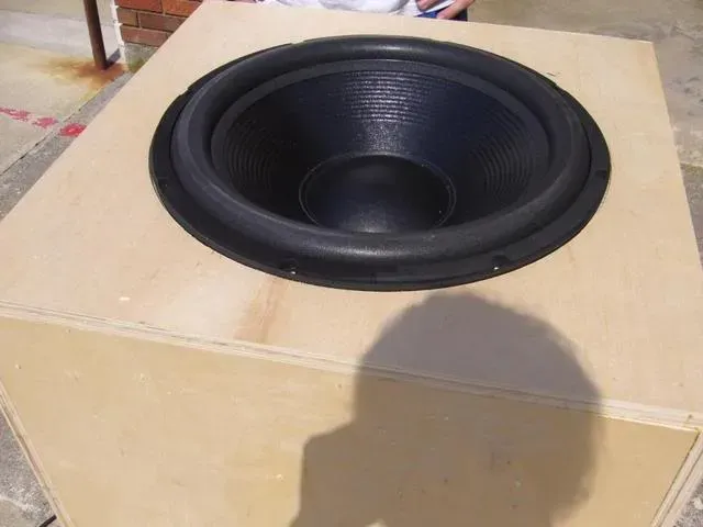

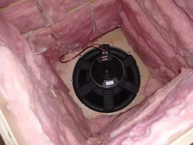

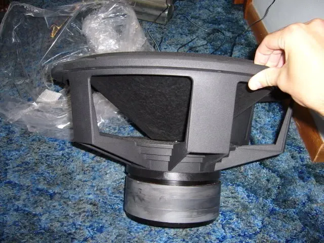

                              Alright, over 2 months later, now my sub is arriving today! I'm still working on the coffee table idea. Updated specs are here. I'm currently thinking about 145 l tuned to 19 hz. Here are the graphs I get for this. I'm posting 2 air speed graphs...one is with a 17cm port I'd have to make myself (modeled w/one flared end), the other is with a 4 inch Precision Port I have lying around. I'd rather use the precision, but is that such a good idea?
                              Other questions:
                              Do I have to subtract port volume from the enclosure volume I put into Unibox? As in, I input 145 liters & the port diameter, it says the port has to be X cm long. Does it already assume that's taking up interior volume, or will I have to add that to the end total volume?
                              Can anyone see any good way to make the enclosure somewhat portable? I'd like to be able to take some of it apart and be able to re-assemble, but as glue seems to be the standard..not sure if that's going to work, but might as well as the more experienced minds!
                              Currently I'm working off of 36" x 20.5" x 16"h, then probably another 5 inches between the bottom of the table & the base plate. Sound good? I know it's the weak way out, but I'll probably only do single MDF for most of it because of weight. I'll double up the bottom and use several braces. I realize this is at least a slight compromise. Maybe I can find BB somewhere around here..hmmm
                              Anyone have any tips for making this look pretty nice? I may end up veneering; at least, I'd like to if I get the money. I'm a little scared to do that though, since this will likely get a little beat up..stinkin' college kids partying in my apartment, don't know how to treat things well.
                              Alright, that's a lot of questions, thanks for any help on this! Pics of the new woofer to be up this afternoon.

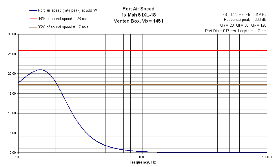

                                Unibox subtracts the port area from the overall volume. Line #66 tells the net volume, line #71 is the gross volume. The difference is the volume of the port.
                                A 4" is port is way too small to use with an 18" driver.

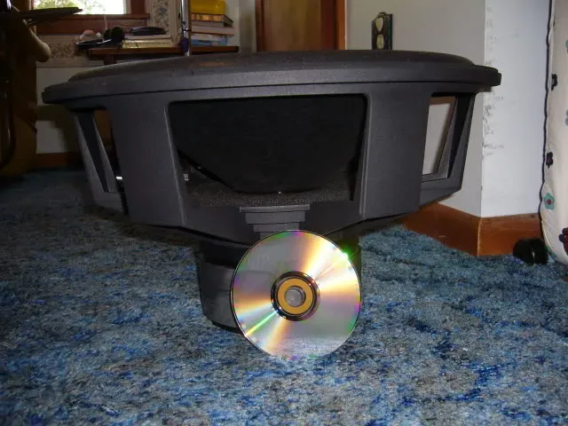

                                    Now..pics! :banana:

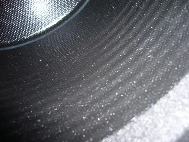

                                    Last edited by theSven; 24 June 2023, 15:25 Saturday. Reason: Update image location

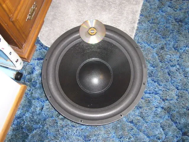

                                      Oh gees, you're going to de-magnetize that CD..... :B
                                      • cobbpa
                                        • 456
                                        lol...seriously? I didn't know that was possible. If it is, I didn't know it. Eh, it was my mom's anyway :-)
                                        • Raptor550
                                          • 132
                                          Lol, CD's arn't magnetized, they are optical medium. However IF anything COULD de-magnetize a CD, that beast would certainly do it! Careful you cat dosnt mistake that for a bed, or worse, a littler box!

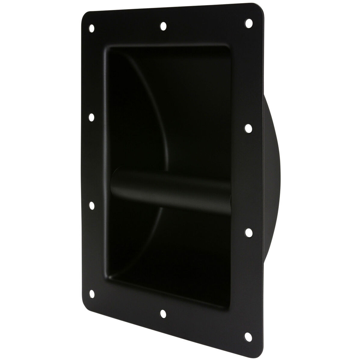

                                                      For a "portable" sub my suggestion is to forget about porting. Run sealed, do a 22"-24" cube. Boost the bottom end with EQ. Install a couple handles like these so there's something to grab a hold of......

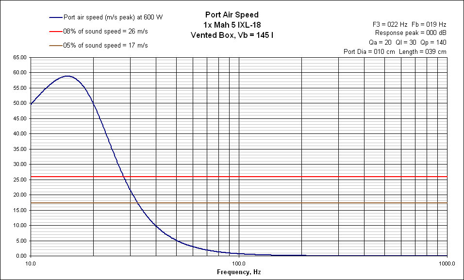

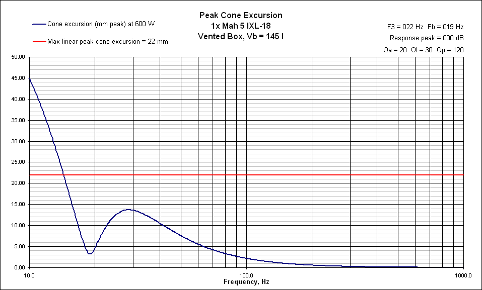

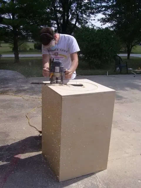

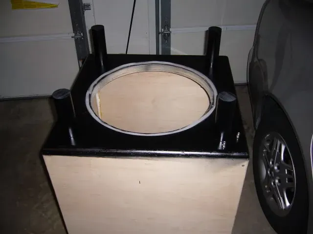

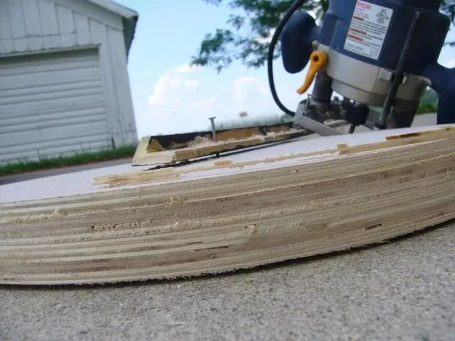

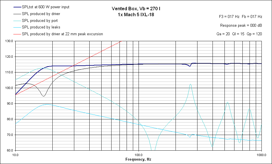

                                                            For documentation's sake..
                                                            The weekend saw some progress. I think I'm going to end up doing a small roundover on the box edges & putting fabric around it--seriously, like a squared tube sub. Heavy as can be though, but it shouldn't be too bad; I plan on borrowing someone's truck or minivan to take down all my speakers & stuff when I move into school in the fall. I will be open to the possibility of buying Sonotube if I ever find some around here, but I'm not too worried about moving it. Anyway, here are some final graphs based on pretty exact numbers. I just didn't end up having the length necessary to use a large enough port to keep that peak of airspeed down, but three 4" ports appear to do a decent job and I had the PVC on hand.

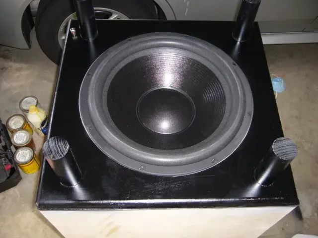

                                                            The speaker in place.

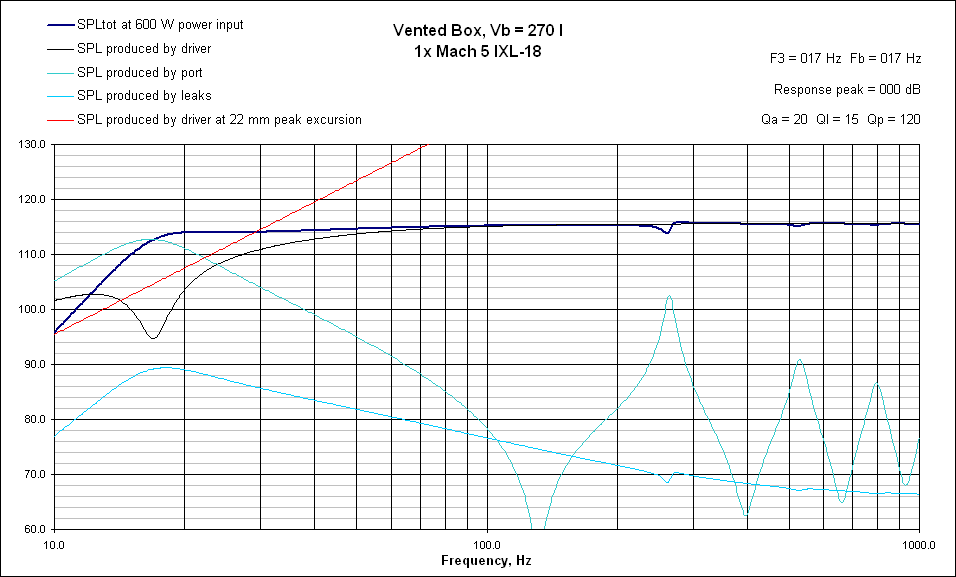

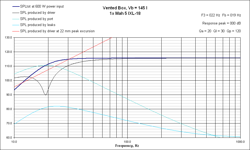

                                                              Just because, here's one last graph. I'm debating about going smaller...once I start gluing in the window braces & such (in a few days) it'll be the point of no return. Current finished height, after 6" legs + baseplate comes out to ~45.25". I could do the compared sealed box by cutting off some of the box I've constructed to make the finished height 20ish inches. Choices, choices...I live on the 3rd floor, but have myself & other college guys to help me move...ehhh...probably doesn't matter to anyone else, but here it is:

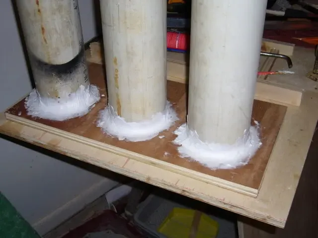

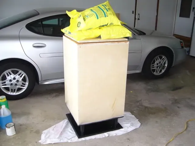

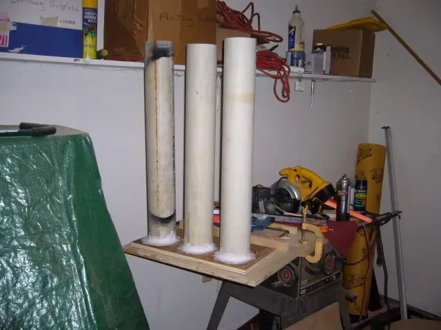

                                                                More progress! You might notice that one of the ports is 1/2" shorter than the others...this was saw operator error. ops: Unibox tells me that's a ~.12 difference in tuning frequency. I'm not worried about it, but should I be? I used LocTite construction adhesive to attach them to the brace and top panel. It's a busy day today, but they should be done by tonight. Casnio Royale just came in from Netflix, so that could be a fun debut

                                                                • cobbpa
                                                                  • 456

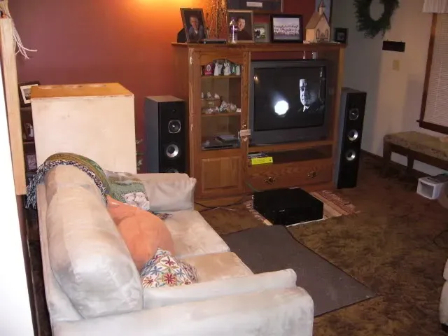

                                                                  Finally got this listenable over the weekend! :B Sadly, I only had about an hour to play with it before heading back to school, so I was mostly dialing things in...still have to work on that some, but it's location is temporary, so I'm not really worried about getting it perfect. Short story from my little bit of time thus far--it's great! Things were shaking a little, gunshots had thump, the missiles in MI:3's bridge scene were impressive..everything was good. Here are pics from the final build stages, more impressions after this coming weekend. One picture is down a port, showing the few (maybe just a couple) inches of clearance between the basket & end of the port--it was close, but I think it's ok!
                                                                  Last edited by theSven; 24 June 2023, 15:29 Saturday. Reason: Update image location

                                                                        Yes, it's a little heavy, but believe it or not I moved it from the garage, up the couple of steps to get in the door, and to that position all alone! Working smarter, that's what it was. :lol:
                                                                        I'm pretty sure I'm going to wrap it in some sort of cloth material for now--something thick that I don't need to paint under, maybe duck cloth? The endges have a 1/4" roundover to knock down the sharpness. If it turns out to be too big in my little apartment, I'll basically cut off the top & cut the box in half to make it a smaller sealed sub. I really doubt that happens, but I'm going to wrap it in cloth and staple it to the ply sides so that if that happens, the cut off portion will be recyclable into baffles or something down the road :T . And, I just generally count on it looking pretty good with a nice stain / poly job on the top & black everywhere else.
                                                                        Yes to your post also, Jim...my mom's little figurings don't stand a chance :B .
                                                                        Anyone care to comment on the bracing I ended up with? Windown bracing was tough to do because of the port length & area they took up; also one would have been inches behind the magnet, so I have three 2" strips of ply per wall. These were cut at 45* on the end & construction adhesive applied to those ends in hopes that would sort of attach them together. Didn't get to feel them for vibrations in my short listening time, but I'll check that this weekend.
                                                                        • cobbpa
                                                                          • 456
                                                                          The 90% final product. Still need to roundover top edges & poly, but it's in place now. My neighbors have mixed feelings.
