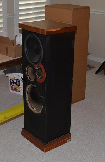

    One of the speakers

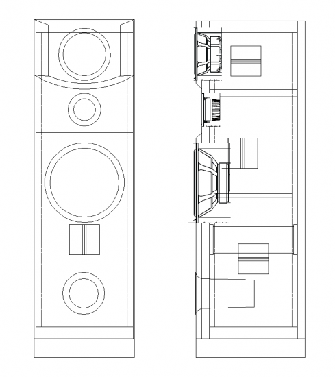

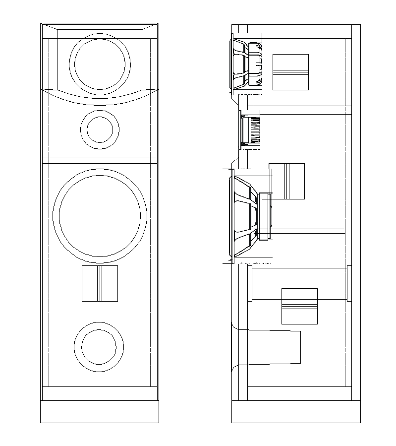

    Sketch of the design

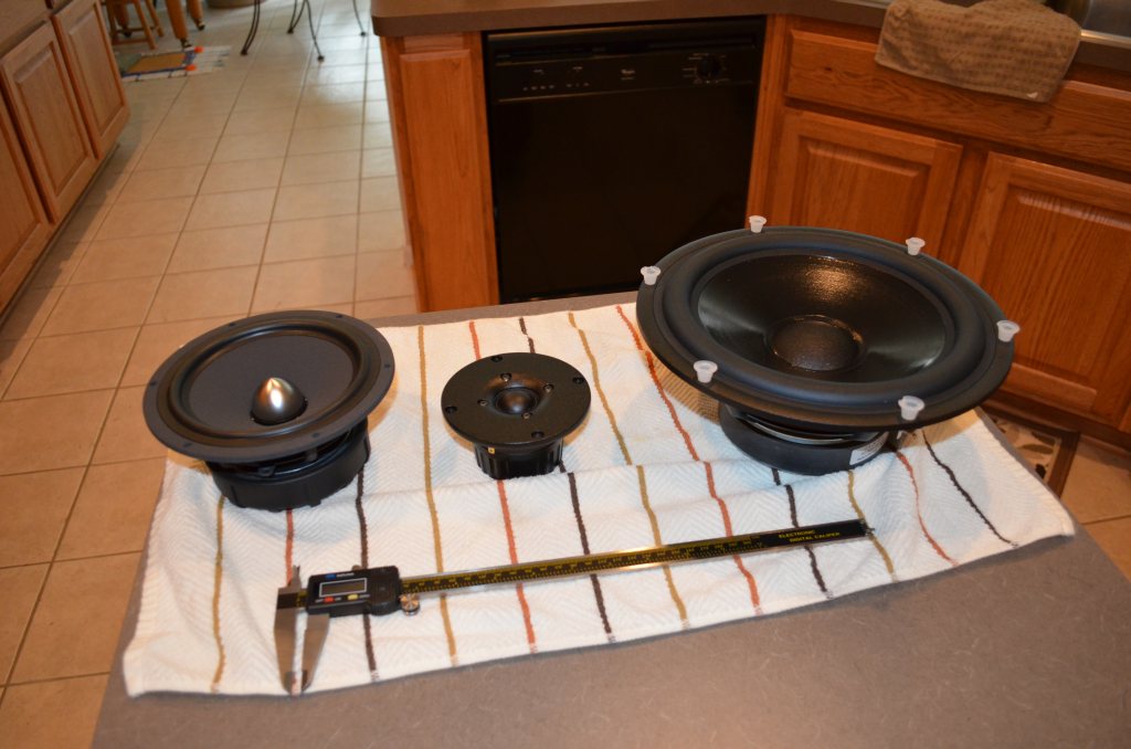

    The drivers

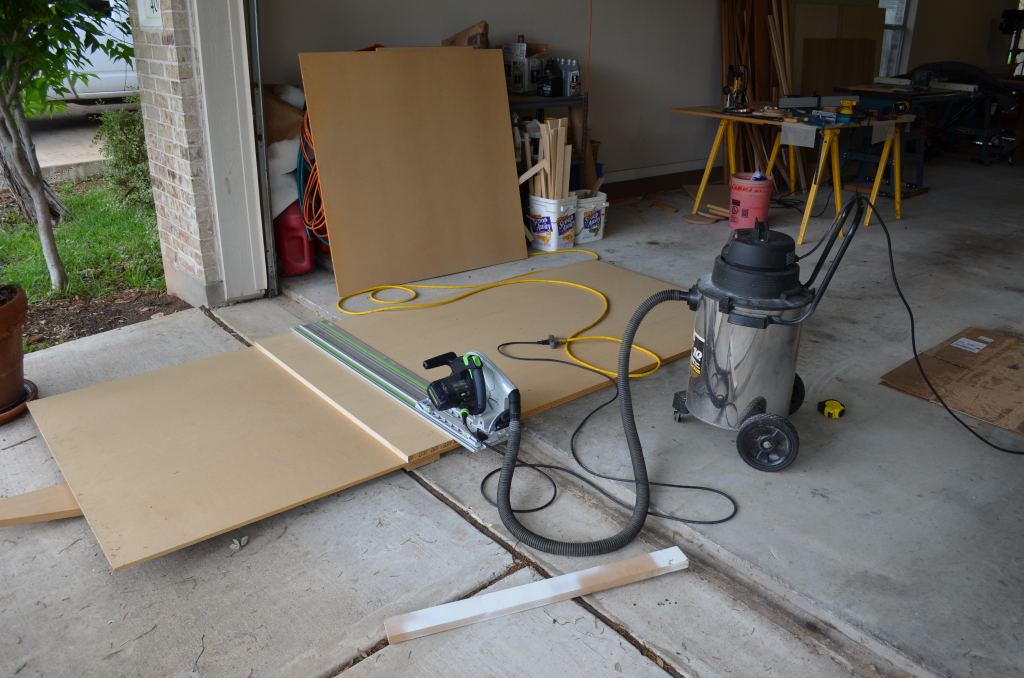

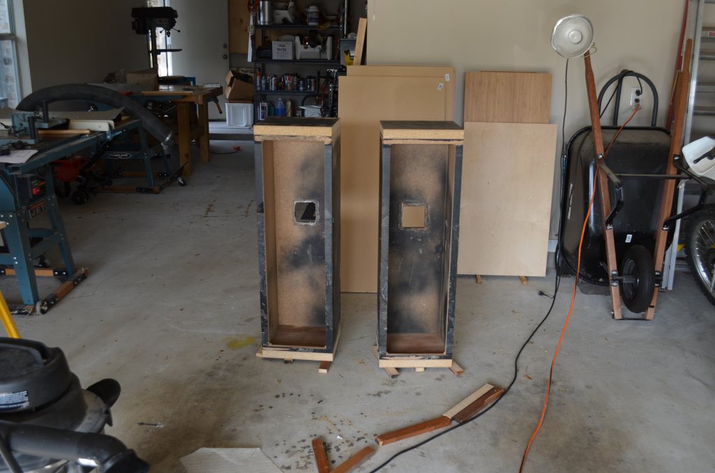

    More pics

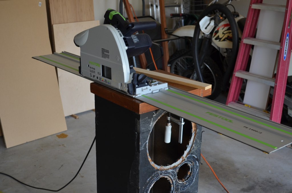

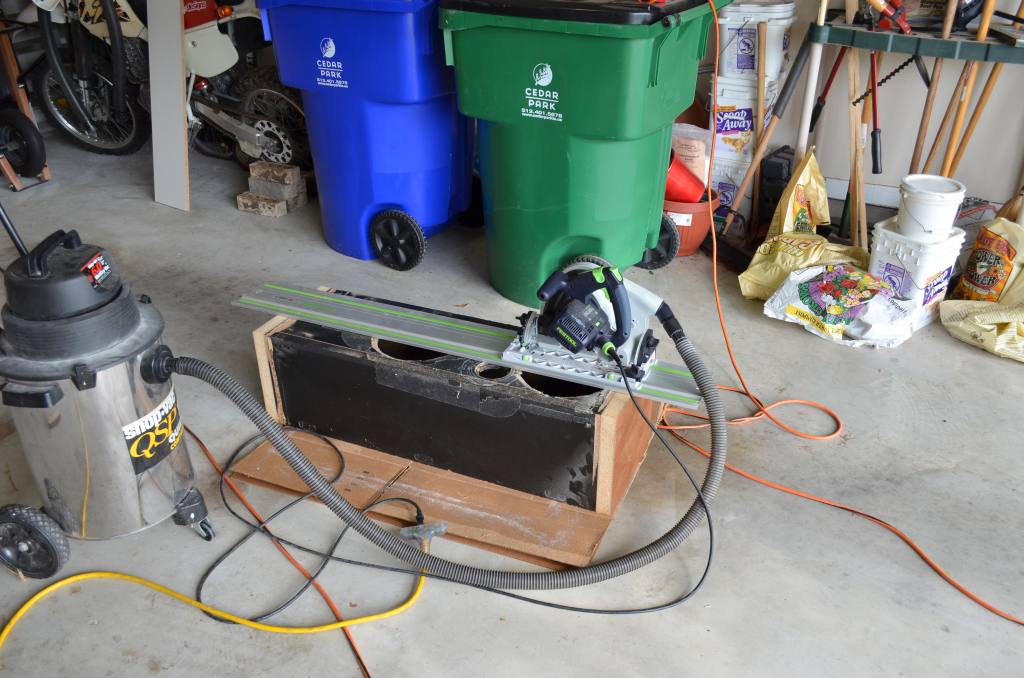

    Trimming with the Festool TS75...simply awesome :T
    Trimming complete
    Plunge cutting is so easy...

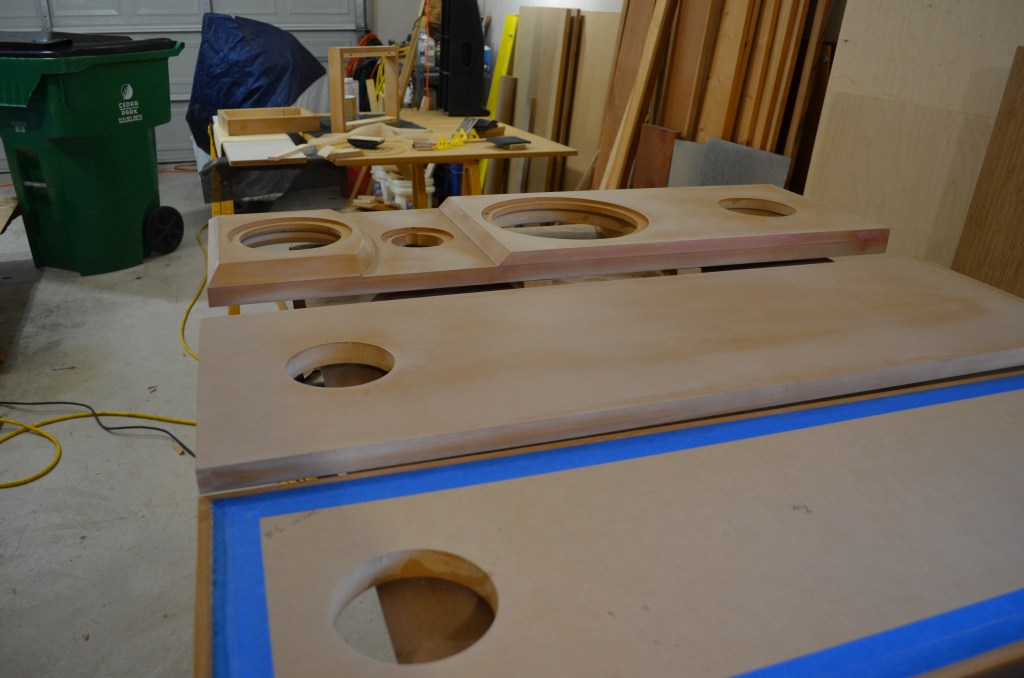

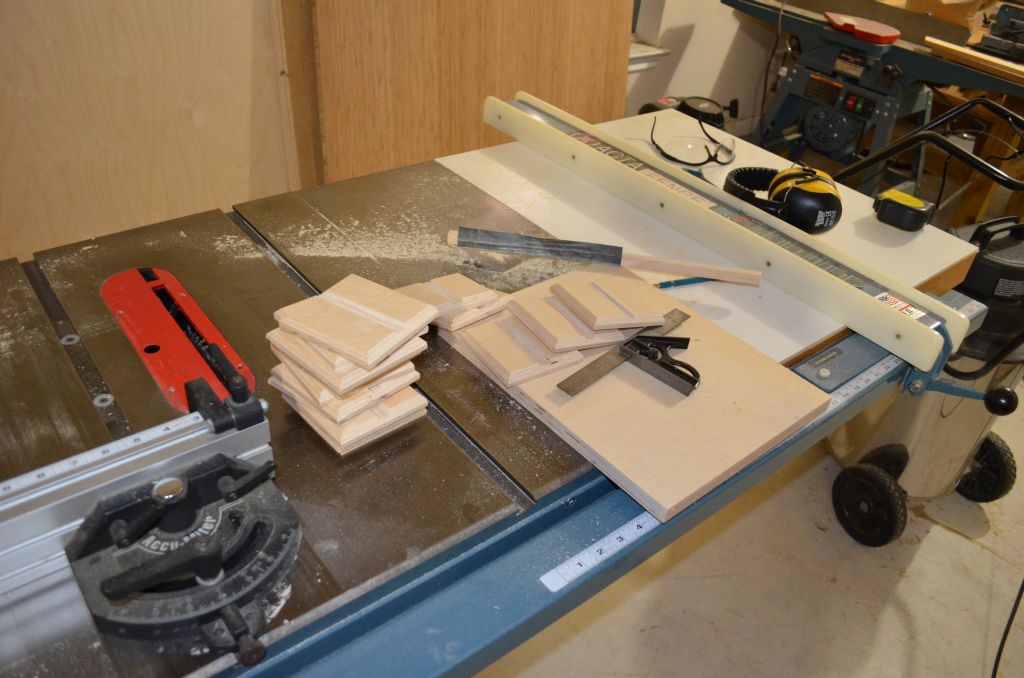

      1" MDF cutting to size

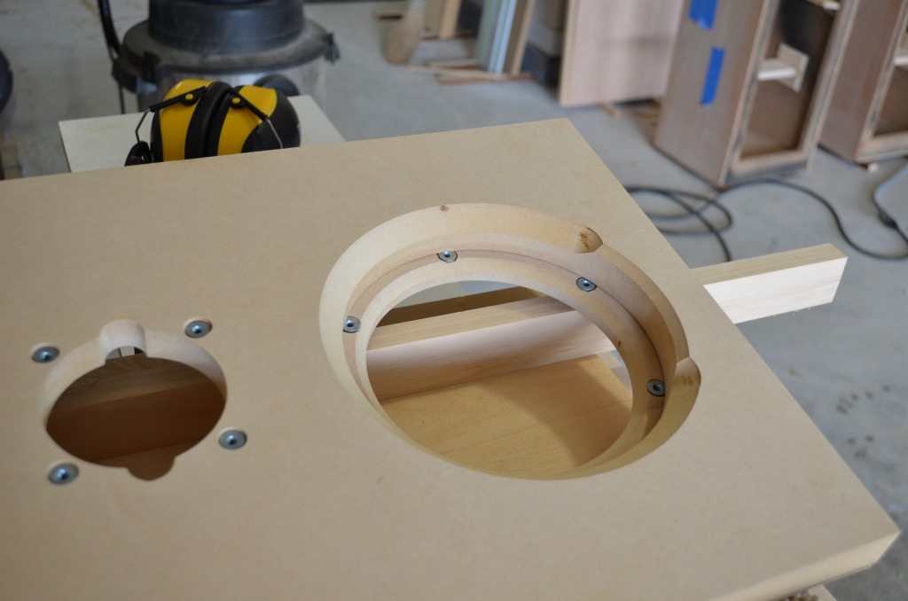

      Mid woofer panel dry fit

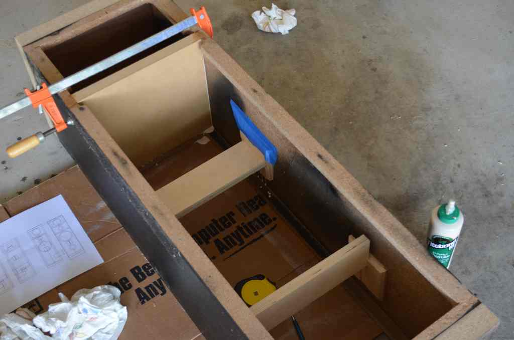

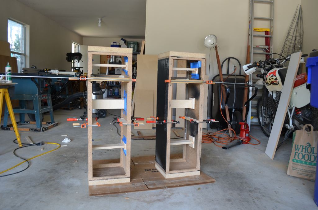

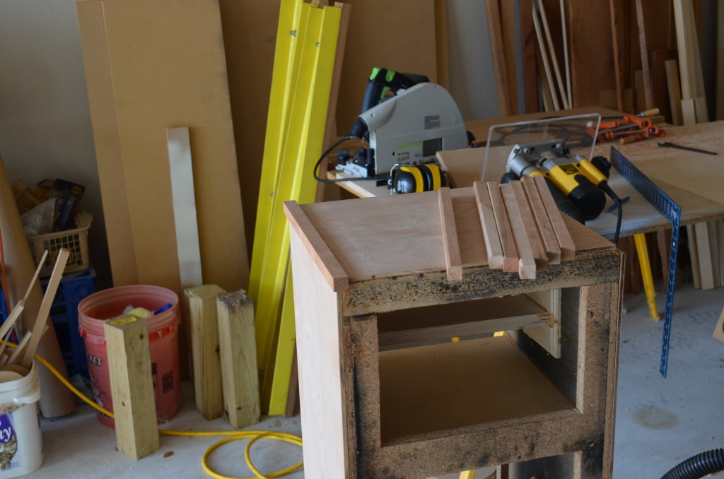

      Bracing blocks
      More bracing

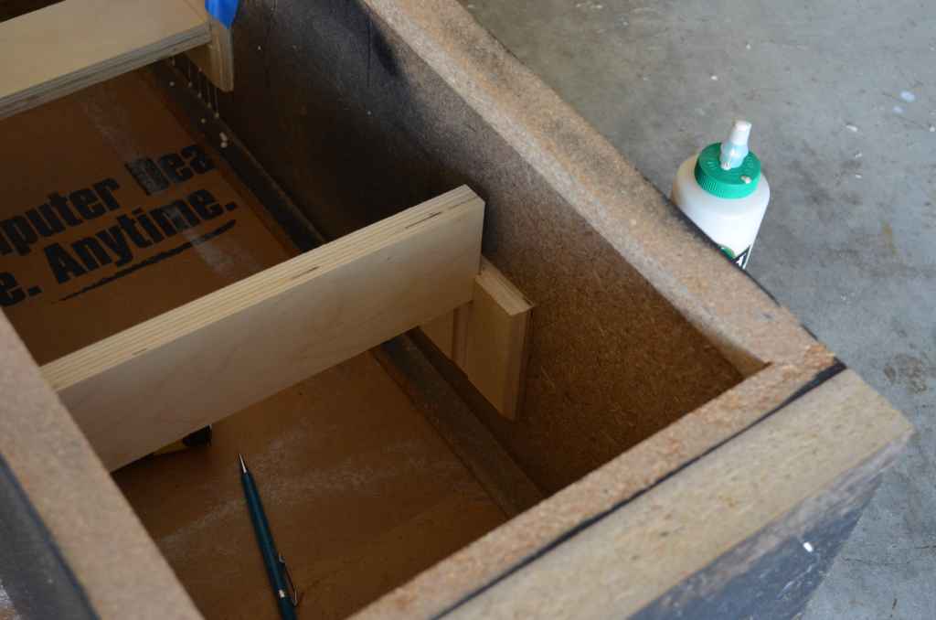

      Bracing detail...allows easy installation of brace
      Last edited by theSven; 16 May 2023, 11:04 Tuesday. Reason: Updatre image location

            • 571

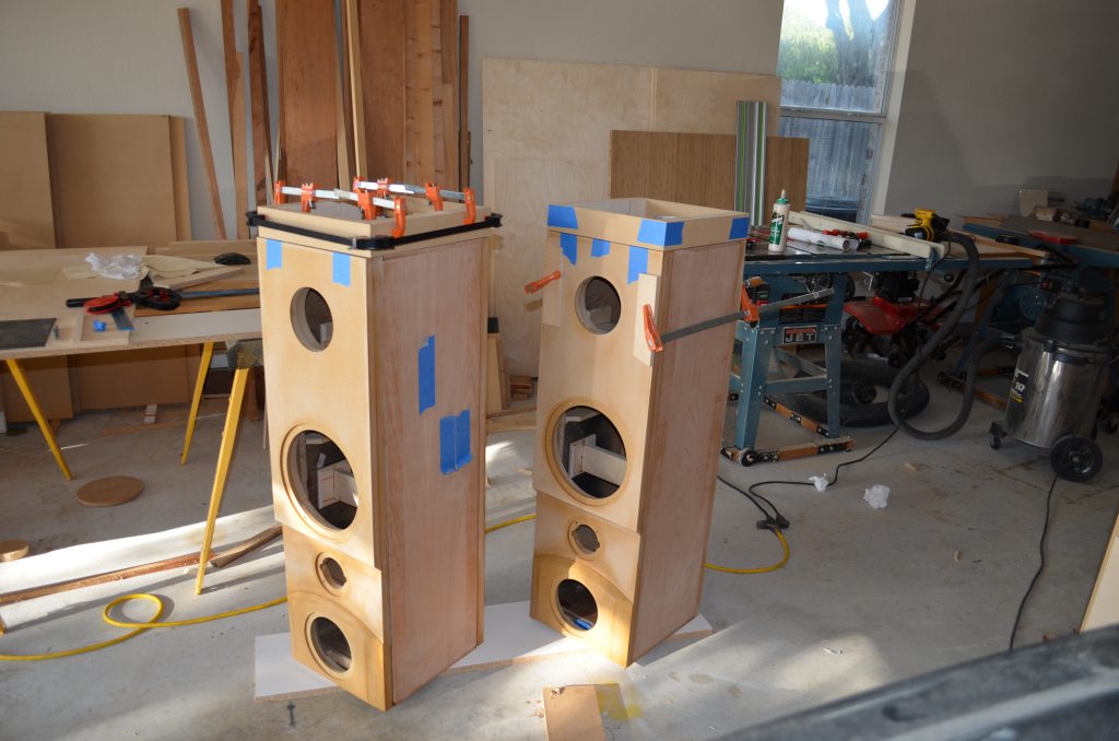

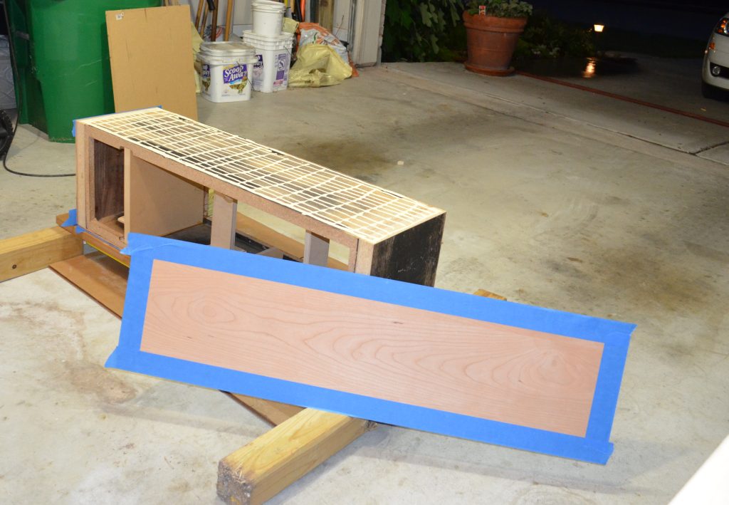

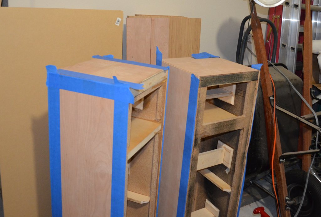

            Braces installed

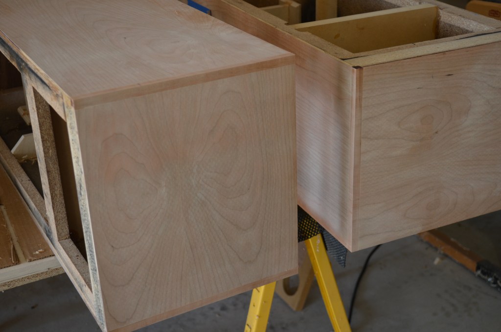

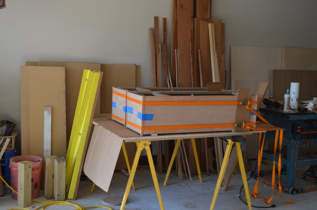

            Applying 1/4" cherry plywood

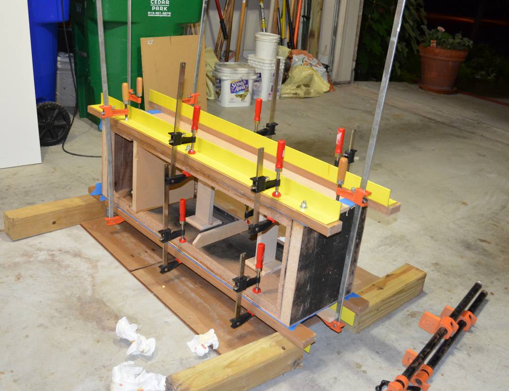

            Clamping...
            Results...
              Good work, there, fellow Austinite! Lotsa clamps - good.
                • 571
                Thanks!...but no comment on the tape...it is your brand

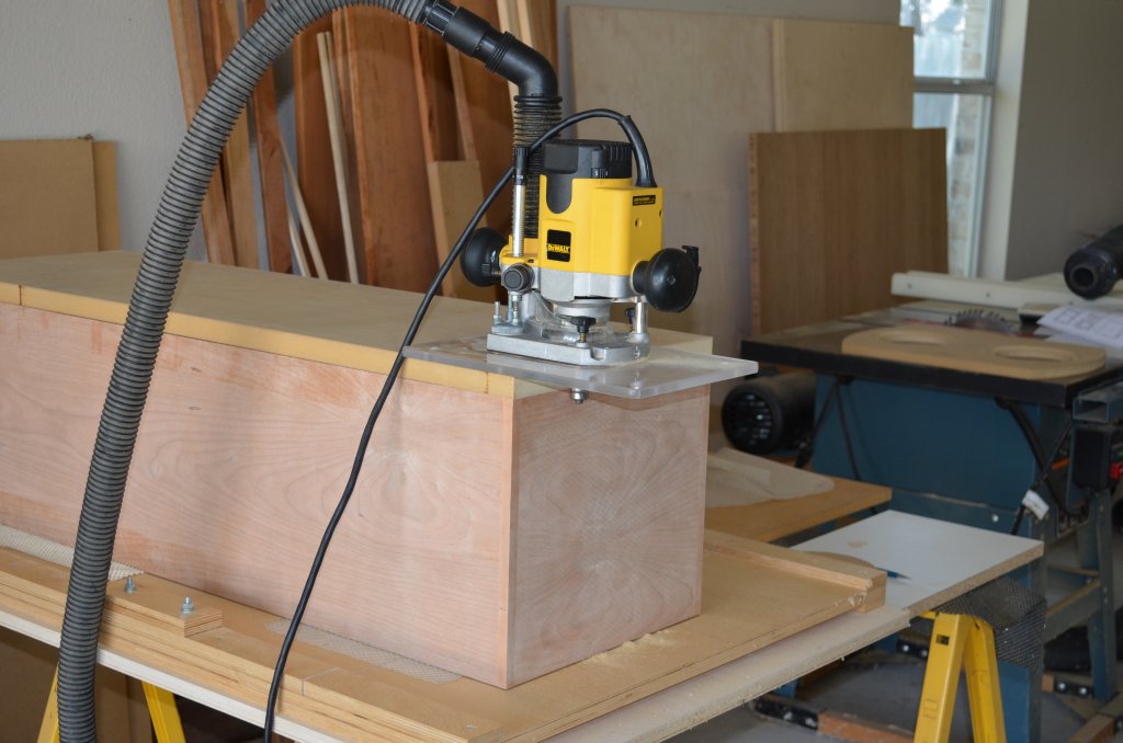

                          • 571

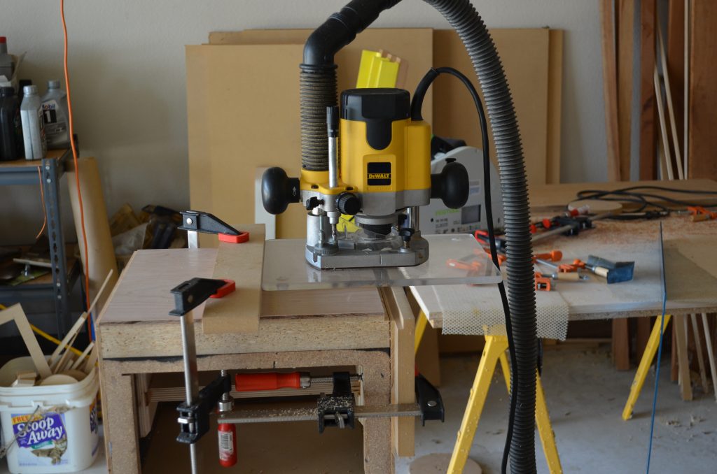

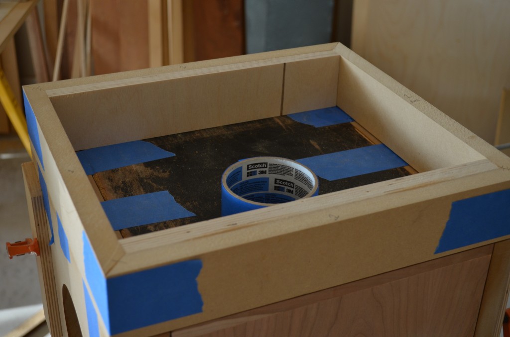

                          Hardwood corners
                          Knowing I probably couldn't miter the 1/4" plywood accurately enough and to provide more damage resistance, I added hardwood corners. I found the sacrificial piece of MDF was necessary to eliminate tear-out of the veneer. Luckily I tried first on a scrap piece.
                          Routing the corner
                          Placing the hardwood pieces
                          Gluing/clamping
                          After flush trim with router

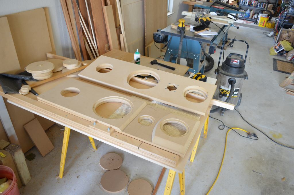

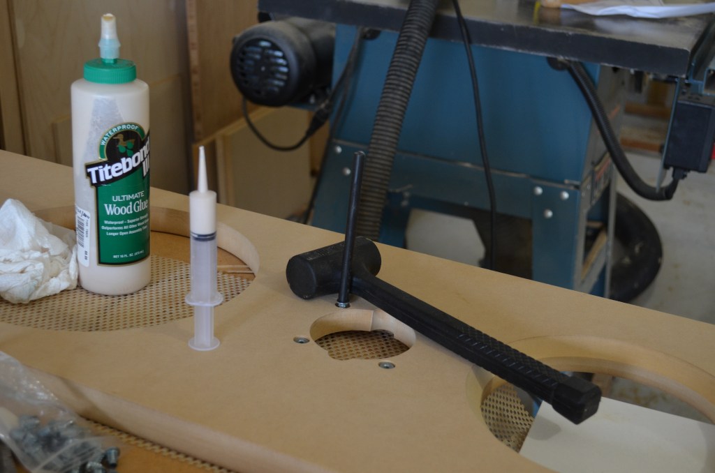

                                • 571
                                Baffles
                                My plan is to have black painted baffles front and back...should give a unique look and is easier for construction.
                                The front mid baffle was made with the help of a tenoning jig for the side cuts and a 45deg router chamfer bit for the top and curved lower part.
                                For inserts I used the PE barbed type...they work very well.
                                Flush trimming of the back baffle to size
                                Front baffles
                                Mid cut out detail
                                Inserts with a little glue for added strength

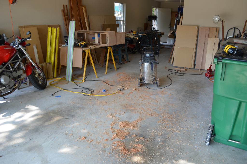

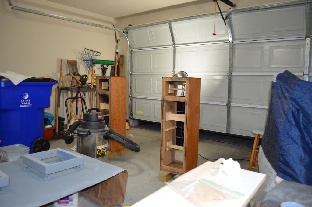

                                  • 2141
                                  Scott these are starting to come together nicely. I had to turn the leaf blower loose on the garage after I flush trimmed my baffles, mdf dust every where.
                                  Steve
                                    • 16194
                                    Coming along very nicely, Scott! Your dust control looks like it works rather well
                                    ! :W
                                      • 571
                                      Steve
                                      Yep...I know what you mean...dust collection only goes so far Jon, just saw your post...looks can be deceiving...this was after flush trimming the cherry corners. Otherwise it works pretty well.

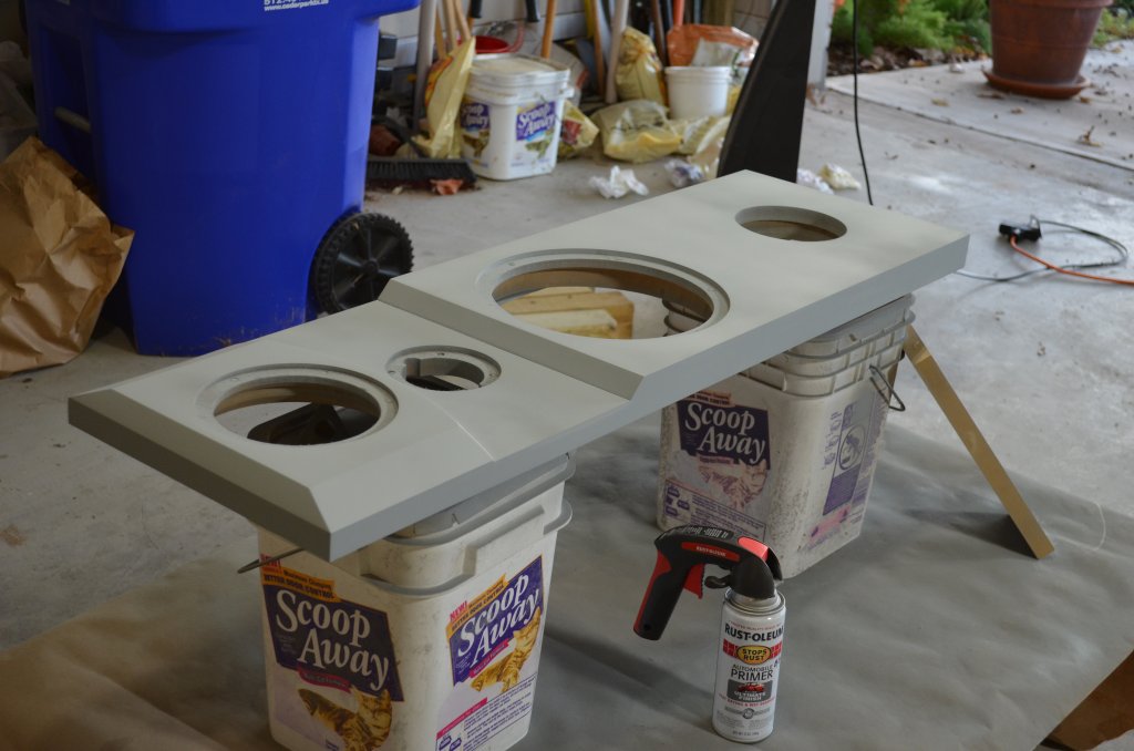

                                                I'm pretty much up to date with the build...this is all current work in progress...so many details left :E

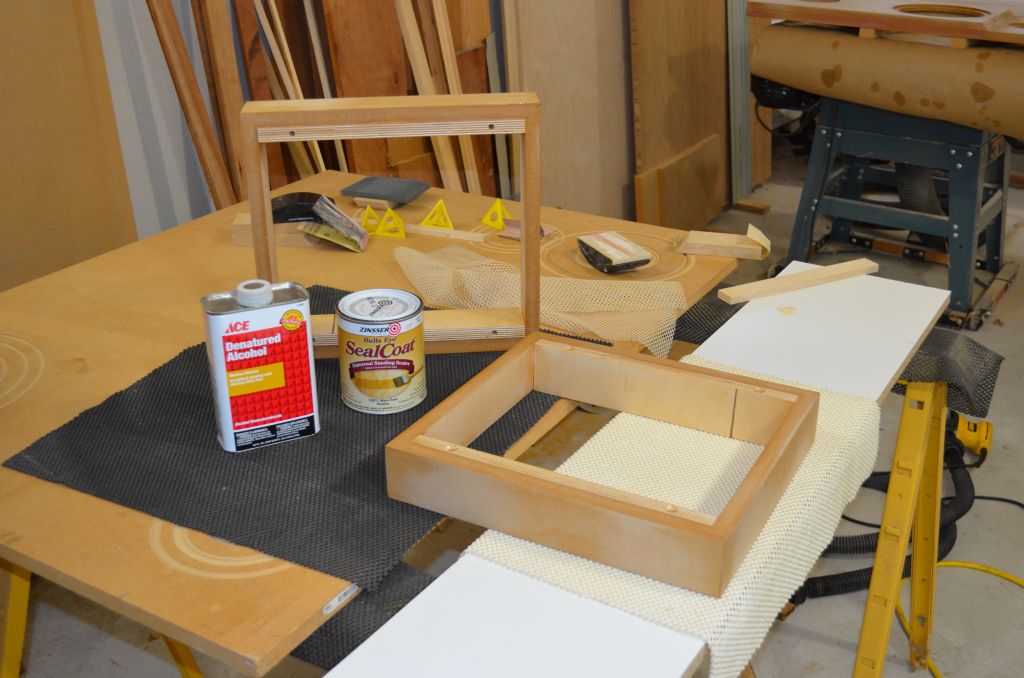

                                                Temporarily attaching the baffles to size the bases.
                                                Click image for larger version  Name:	DSC_0141_sm.jpg Views:	10045 Size:	98.7 KB ID:	857817
                                                Base detail...I made a small rabbet cut around the baffles to provide a uniform gap.
                                                Click image for larger version  Name:	DSC_0142_sm.jpg Views:	10094 Size:	95.7 KB ID:	857818
                                                Zinnser's SealCoat works well for sealing MDF...I diluted it a little with the alcohol for better initial absorption. It really strengthens the edges as well.
                                                Click image for larger version  Name:	DSC_0164_sm.jpg Views:	10146 Size:	96.9 KB ID:	857819
                                                Baffles ready for primer...added a little Bondo® Glazing & Spot Putty to the edges. Internal rabbet edges shown with blue tape for glue masking.
                                                First coat of primer applied
                                                Click image for larger version  Name:	DSC_0180_sm.jpg Views:	9922 Size:	95.1 KB ID:	857821

                                                      • 16194
                                                      Getting VERY close I'd say! :T Painted front panels! :B
                                                      Thanks for sharing more pictures of your progress!

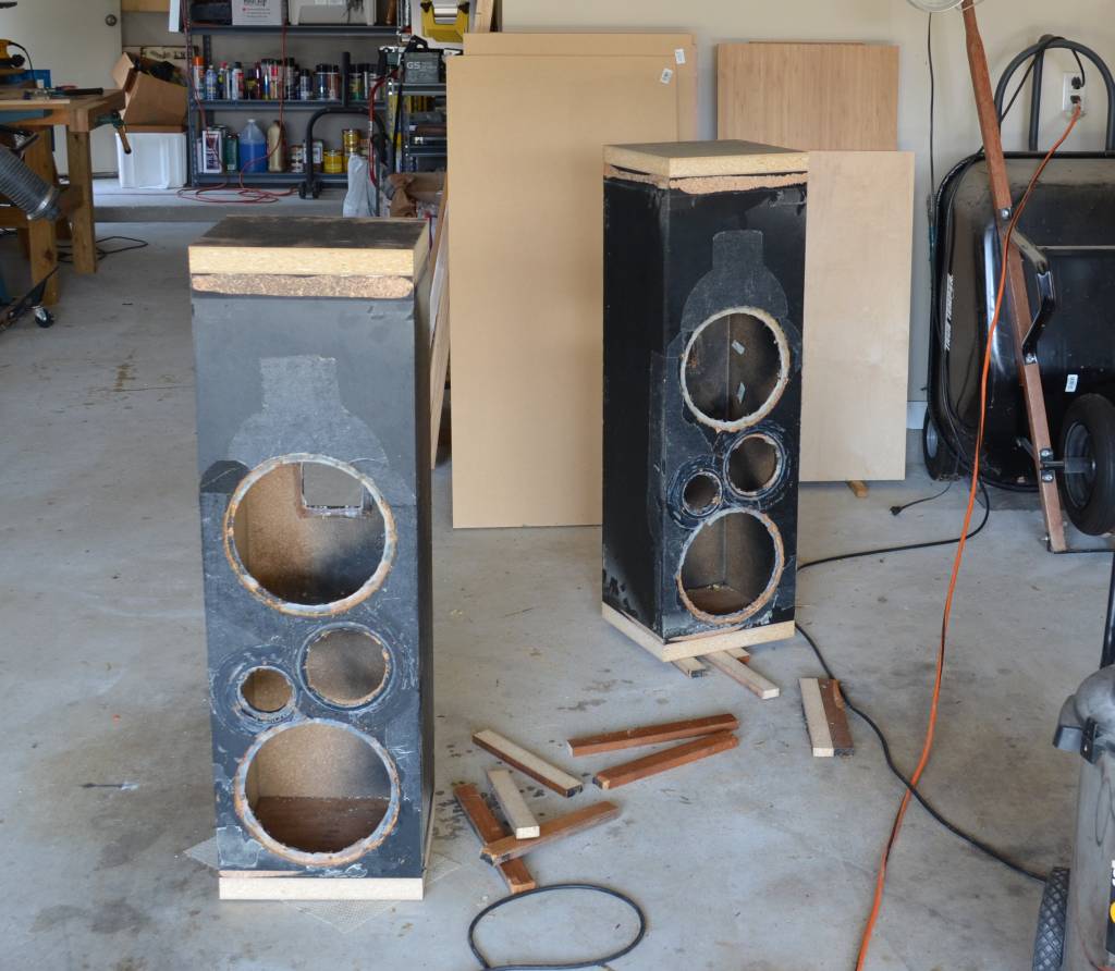

                                                          • 571
                                                          Progress and setbacks...
                                                          ...such is the story of life... right :W
                                                          I applied top coats to the cherry portion of the cabinets and that turned out well...the painting, another story. As others have said I should invest in a HVLP spray gun but I was hoping I could get away with the rattle can approach. This morning I even made a paint stand for the baffles to get a better spray angle. The satin black finish is just not acceptable...blotchy and a few runs. I hope I can do better with the spray gun. As Steve suggested I might look at the Earlex Spray Station HV5500 HVLP. I welcome other suggestions.
                                                          Anyway, here's a pic of the cherry

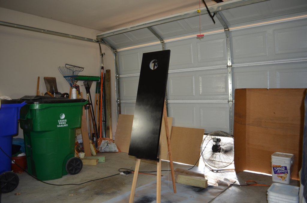

                                                          A rear baffle with a couple coats of paint

                                                                                        • 571
                                                                                        I'll be trying satin black so I hope it will not be too difficult.

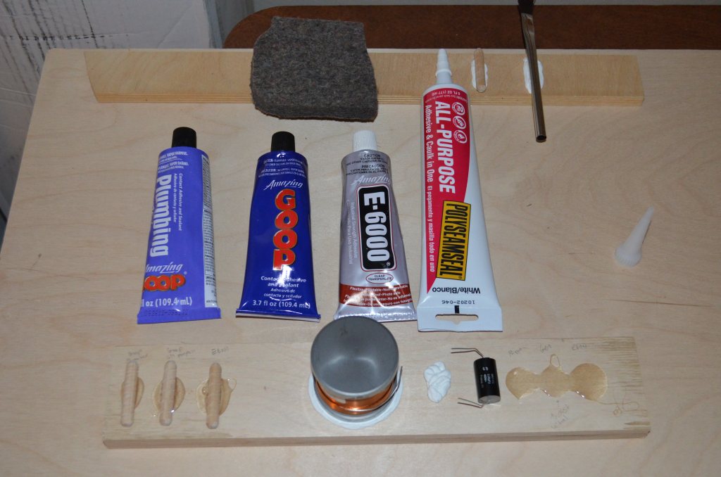

                                                                                          • 571
                                                                                          Adhesives...
                                                                                          I tried a few adhesives for the x-over and damping material (Steve, I saw your question...here's what I've found). The water based Polyseamseal works well for the felt and Whispermat I plan on using. I prefer it to the spray adhesives because I can apply it only where I need it. It grabs very well to those surfaces. For the x-over components I'll go with one of the Goop products, E6000 is made by the same company. All three are pretty indistinguishable. They will definitely support components hung upside down...Here's a pic for your enjoyment
